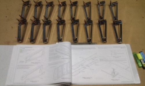

Brief Description:  Preparing elevator ribs
Started on the elevators this afternoon. Sectioned off all of the ribs and deburred. Completed the match drilling of the holes associated with each half of the rib......
16 of these took me 4 hours of time for all of the cutting drilling and deburring. Wow. I can see where the time goes.
Ribs cut and deburred
