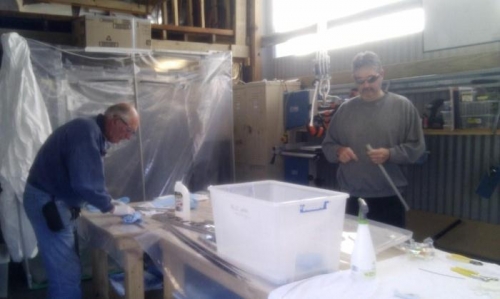

Dad and I spent Saturday cleaning and acid washing the parts ready for spraying the primer. I completed a priming of the part noting that the main issue is applying the priming to thick.

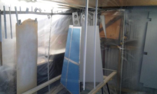

The interesting part of this was that I had actually applied the primer to THIN.... and so another coat was in order. I completed this Tuesday night, inside the 72 hours max between coats. All the parts are now ready for riveting on Saturday and Sunday.
I have now developed a paint volume rule of thumb for the application of the primer to the parts.
1. For small thin or plate parts (5 mil)
2. Meduim parts (7 mil) (i.e. small ribs)
3. Large parts (10 mil)
5. Skins (15 mil up to 20 mil)
This will allow for a volume calculation for mixing of the paint volume. If you use this as a starting point and then make some modifications later, you should end up pretty close.
Dad and I preparing parts

Parts sprayed.
Parts sprayed.
