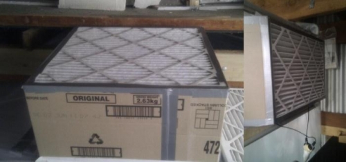

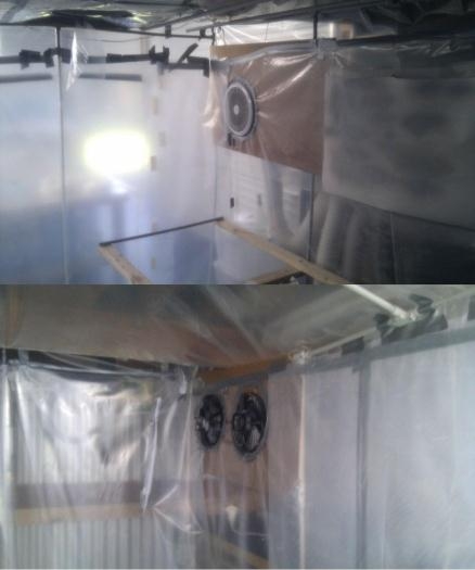

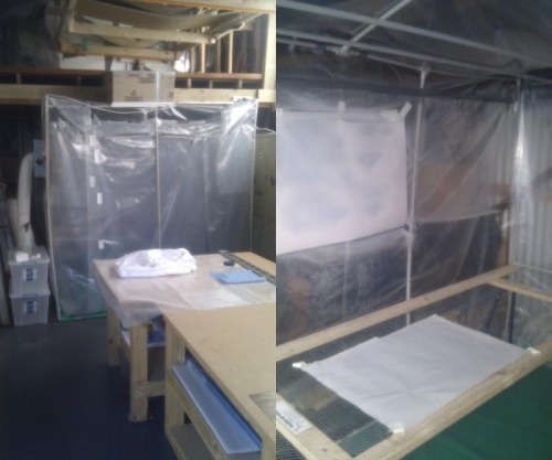

I have recently prepared a spray booth from electrical conduit, 3 exhaust fans, 1 large fan, 2 filters, plastic sheeting and duct tape. The result is quite good. The booth is under constant positive pressure and can be fairly easily disassembled if required.
Spray Booth
Spray Booth
Internal Fans
Internal Fans
Filters
Filters
