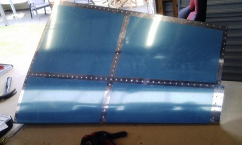

I have assembled drilled, unassembled deburred, assembled, drilled, unassembled, deburred, covered the dimpling table with carpet, dimpled AND.........whalla!!!!
I have a completly dimpled VS skin and all of the ribs ready for the final assembly. I still need to countersink and debur the VS rear spar, however, apart from that, the VS is virtually ready for priming.

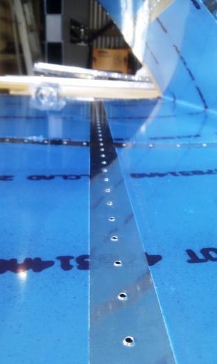

Dimpling the VS Skin
Look at that line  :-)
VS skin dimpled..
VS skin dimpled..
