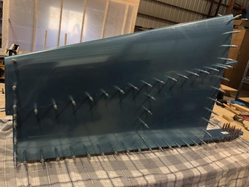

Brief Description:  VS - Skeleton and skin
Prepped vertical stab ribs (VS-704, 705, 706, 707);
Cleco'd ribs to front and rear spars;
Final drilled VS-808PP, VS-410PP, VS-411PP and VS-412PP to VS-803PP to #30;
Drilled all rib to spar attach holes to #30;
Cleco'd and match drilled VS-801PP(skin) to skeleton;
Marked all pieces as it was disaddembled, de-burred, dimpled and/or countersunk all VS parts (except skin)
VS Skeleton
VS Skeleton
VS Cleco'd together
VS Cleco'd together
