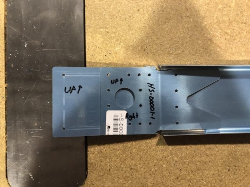

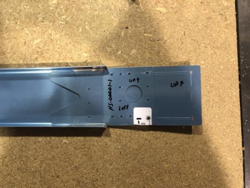

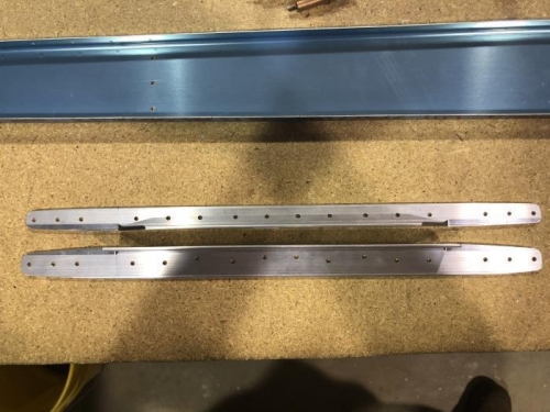

Built a bender (2-2x6 boards with hinges) and mounted it to work table; Bent the HS-702 tabs (bender would not work for this); Clamped, cleco'd and drilled HS-00001 (spar doublers) to HS-702 (spars); Tapered the ends of HS-710 and HS-714.
