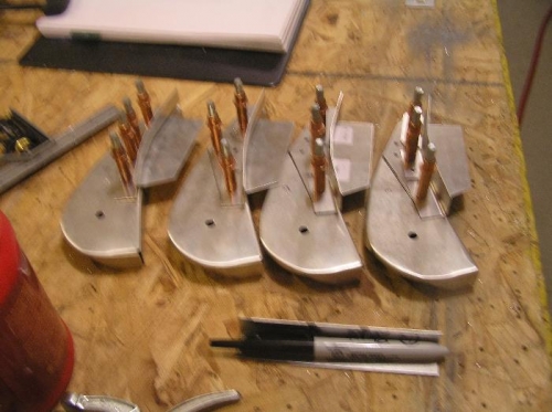

Sect 3
Slats
Assemble 7S1-1 and 7S1-6 rib to support brackets. Cut "L" and drill and notch to match curvature of rib.
