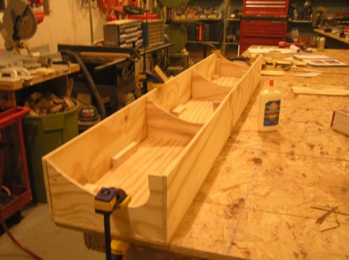

Switching to slats, I started building the slat jig from 3/8 inch plywood. This is just time consuming but with a good band saw, it is a snap. I glued and screwed the jig together with blocks of 3/4 inch material. Making sure the sides stayed stright was the most impotant thing.
