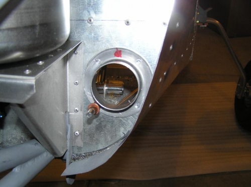

Throttle cables
Cut and attached to two throttle cables making sure they both start moving at the same time. Also checked to make sure the closed throttle dimensions are the same. Then added the heater scat tube flange and mated it up to the flapper valve.
