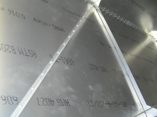

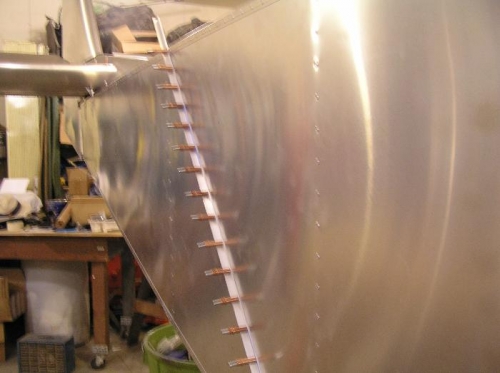

I decided to install "L" angles on the inside fuselage skins to avoid the "oil-canning" that is described by the other builders. Took a little work to align the angles and holes.
Layout holes
Drill
Reverse and rivet.
