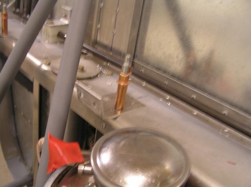

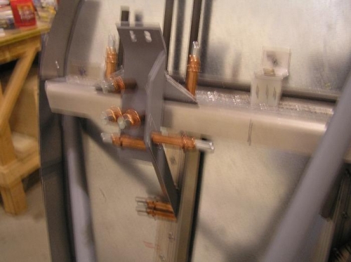

Cut and drill 7E5-3 throttle stop. Bend and drill 1/4" holes for cables. Cut "L" angle brace. Drill, prime, and cleco in place. Drill choke stop and cleco.
Throttle Cable Stop
Choke Stop
