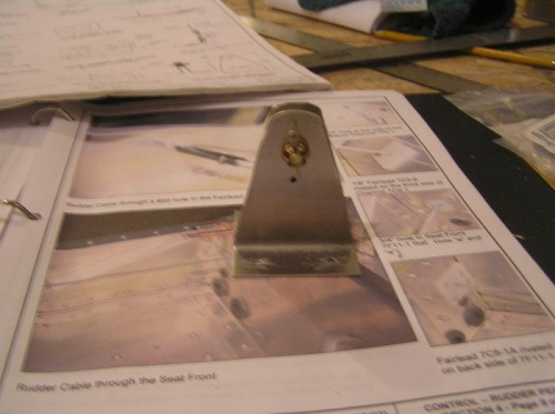

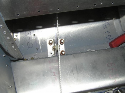

Brief Description:  Rudder cables
Drill center pin holes in 7C5-7 pulley brackets. String the cable path and position and drill the cable brackets to the floor. this is no easy task as you cannot "eyeball" it very well. Used a square on the floor to set the center of the cable brackets. It looks sligghtly off to the side in the picture but that is the angle of the camera.
