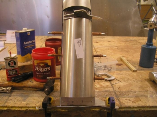

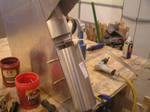

Date:  7-9-2009
Number of Hours:  1.50
Manual Reference:  Sect 1 pg 11
Brief Description:  Rudder
Fit rudder to fuselagfe with 3 washers on top and one washer on the bottom. Fits up very well. Both hinge points are set so now we can drill in place the 7R3-4 lower spar faring, and set the upp spar fairing in place but will not drill until the Horizontal Stabilizer is set in place for clearance.
