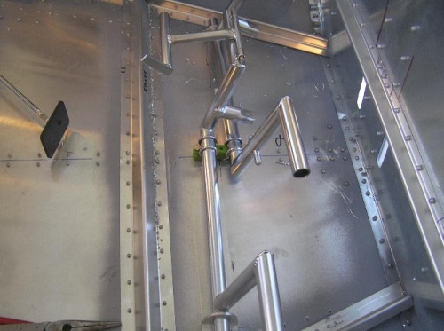

Rudder Pedals
Layout position for 7C4-2 center pedal bearing and drill 3 holes. Layout and drill 3/4" holes in both 7C4-3 outboard bearings. Layout bearing bolt holes and drill thru floor.
