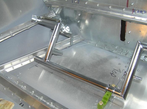

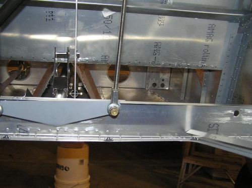

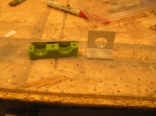

Cut the aileron control rod ands and bolt up to the horn and the bell crank both sides. layout and cut the 3/4" hole in 7C4-3 pedal outboard bearings. Bolt in the center bearing.
