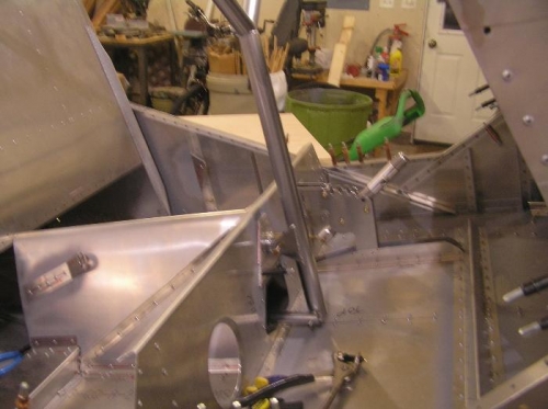

worked on the central stick and fit to the torque tube. Cut the bushing and drilled the hole in the pitch control rod 7C1-3. cut the slots in the end to fit the bell crank. Trim bottom of central stick for clearance. I bought an after market flap control lever and it is very nice and easy to install.
