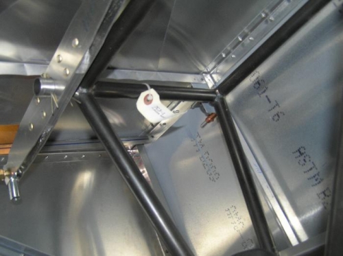

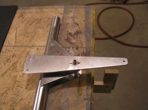

Attach 7C1-2 Bell Crank to 7C2-2 Torque Tube. I had the controls chrome plated at the local plate shop. then they did a "hydrogen bake" on all plated parts at the local heat treat shop to make sure I do not have brittleness.

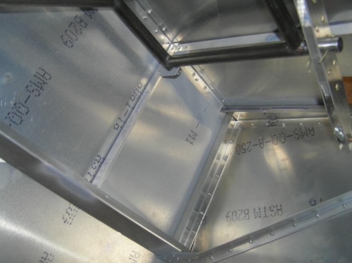

Install 7F6-3 Bearing and install control mount 7C3-1 into the plane. then started flap control linkage.
