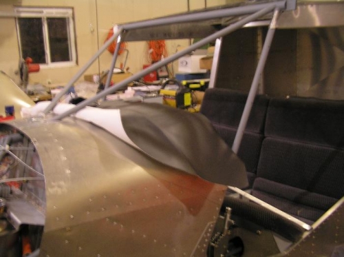

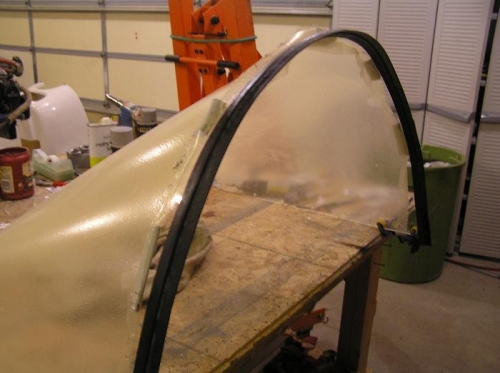

Mark abd cut windshield.Clamp drll and cleco 7F19-8M side trim to both sides. Remove windshield, enlarge holes, to 1/4" per plans. Cut pitot tube spacers and insert in holes using RV sealer and install weather strip to bottom of windshield.
