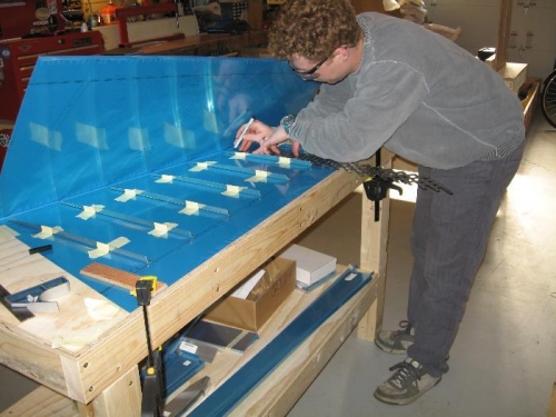

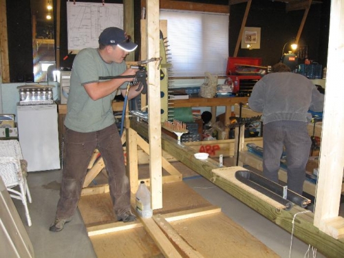

Lots accomplished today with a great deal of help from Mike and David today.
Sub 2: VS2
Vertical skeleton was mounted on the jig and made ready for skinning
Sub 2: VS3
Skinning of the vertical stabilizer completed
Skin Trimmed for proper fit and made ready for dimpling
*note:
Decided to remove and replace VS-402 forward spar as a few of the holes drilled out had fallen towards the edge of the flange and are close to (or exceeding) the nominal edge distance!
Sub 3: R1
Skin stiffeners cut and trimmed to fit
Sub 3: R2
Skin stiffeners shaped, smoothed and polished
