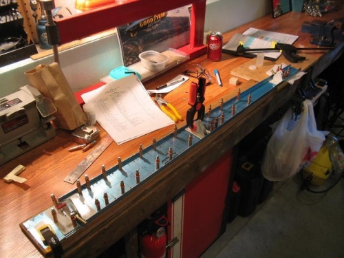

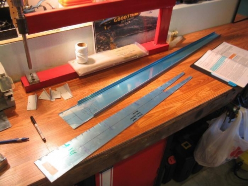

Brief Description:  Building the Vertical Stabilizer Rear Spar
Rear spar of the vertical stabilizer mated with reinforcement plate, rivet pattern laid out and drilled.

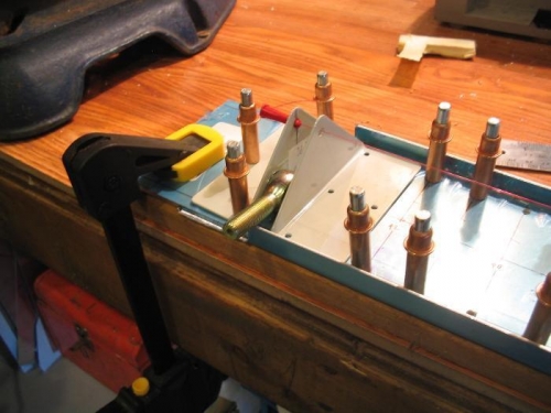

Hinges located and drilled.
Cut lower end shape into reinforcement plate.
Final cleanup of parts required, followed by deburr, primimg and countersinkink/dimpling for flush rivets on lower portion of spar.
*note: used fishing line and plastic drywall anchors again very sucessfully to locate hinge centerlines as illlustrated in images
