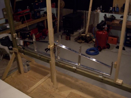

Mount HS skeleton in jig

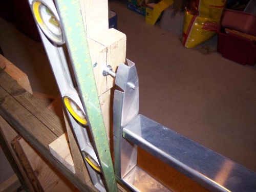

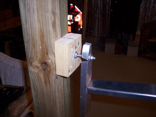

Added hinge and rib tip brackets to jig.
Completed required modifications to jig made HS assembly true.
Clamped and ready for procedure HS6 - Skinning Horizontal Stabilizer
*note: for assemblies removed from hinges, bolt heads are oriented inward on inner hinges and outward on the outer hinges.
