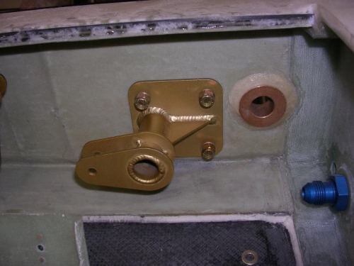

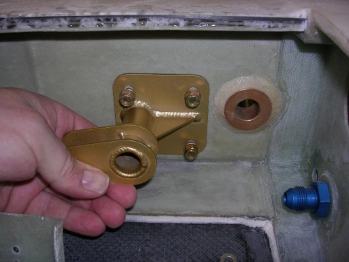

Slotted the aileron idler mounting holes
Finished slotting the holes on the aileron idlers. This should allow the inside aileron pushrod to not hit on the top of the landing gear trunion. Installed and torqued and marked
