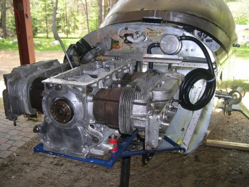

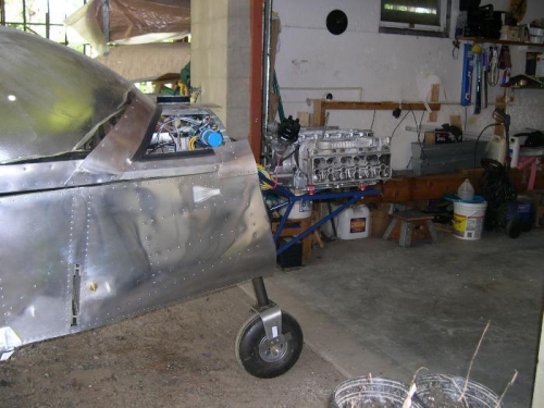

Brief Description:  Old core engine on frame
Had originally set engine on mount without crankshaft.
Tore engine down enough to put in crankshaft, used a shaft from small engine Non 8409).
Installed with out bearings so it is sloppy and installed with the small cylinder barrels.
This should give me the dimensions I need to fit the cowl, carb heat and rest of controls and wiring
so when I get my engine it should just be the installation.
