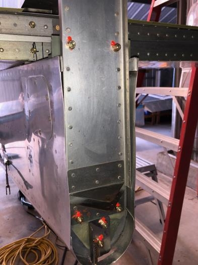

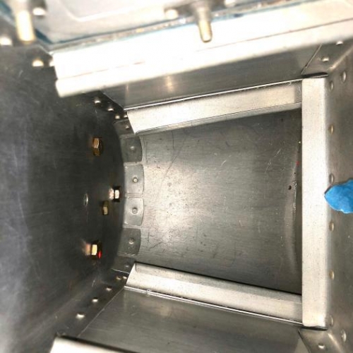

The RV6 plans are no where near as precise as newer models and DWG 34 Sec C-C showed three AN4 bolts on the bottom of the Vertical Stabilizer Spar being inserted from the Aft forward so thats what I did. Frankly, threading washers and nuts from inside there was a real arm twister but it was doable. Later, I saw a different view drawing and it showed bolt insertion from the inside of fuselage side. Go figure. I remember old hangar discussion about bolts facing rear, yada yada yada. I recall seeing RV7 plans where bolts face both directions in many places, even some main spar bolts.
So, to either win an argument, or to satisfy my curiosity, I emailed VANS once again. Regardless, I did reverse the 6 bolts holding the VS rear spar rather than wait for VANS answer. I'll add their answer here when it arrives.
The original bolt up.
The final bolt up.
The final bolt up.
The final bolt up view inside.,
