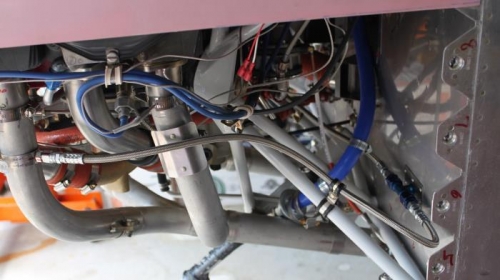

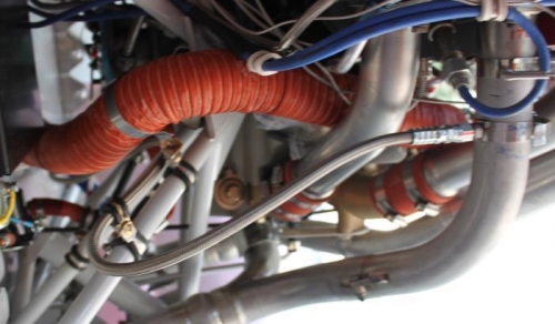

Brief Description:  Smoke System Install 4
Connected oil lines to the injectors and tightened all fittings. Secured lines with adel clamps to the engine mount tubes. There is nice room for engine vibration and movement without stressing the connections. #4 exhaust pipe has a heat deflector installed to keep the nearby oil line cooler.
