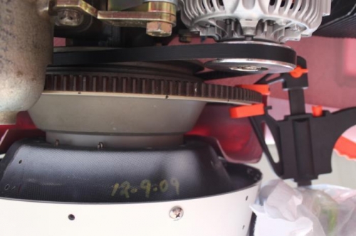

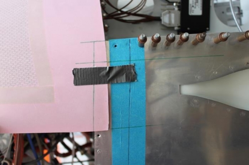

I didn't find much guidance on installation of the WW200 RV prop and cowl. I was curious how the spinner backplate and the forward face of the cowl related to each other. So, I took these pictures to remind me how close they are. I did note that one side seems closer to the spinner backplate than the other side. Does the engine point to the right slightly? Is it a sloppy cowl? Will it all attach together and pull itself into identical distances between the two all around? We'll see.
Reference lines on fuselage side skin. Not a lot of extra cowl.
From underneath you can see how spinner back plate and cowl relate to each other.
Cowl is aligned but pink flange is not same spacing on each side of starter ring. Why?
