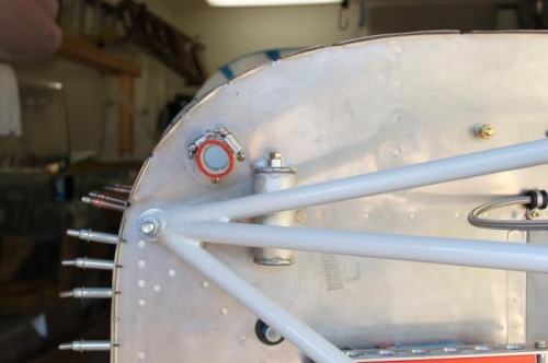

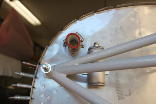

Located the co-pilot side electrical passthrough outboard of the brake reservoir. Installed it just like the pilot side. Its a Safe-Air fitting with the firesleeve and silicone tape fillers.
