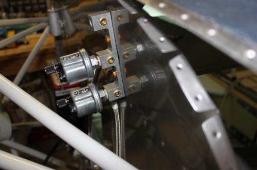

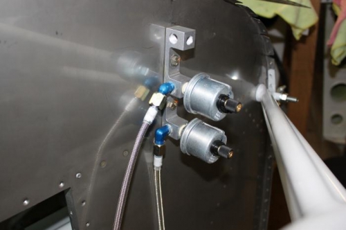

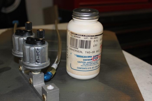

Drilled the 3 position manifold to the firewall, then found the assorted parts and mounted the plugs, the fittings, the oil and fuel pressure lines and the two Dynon sensors. I used Bakerseal (with PTFE) for all the plugs and 45/90 degree fittings. Of course, nothing on the flared fittings other than correct tightening procedures. I noted that if you mounted the maniford 1st, then you could not insert the 45 and 90 fittings without interference with the firewall. Some build sites show using a spacer behind the manifold to push it away in order to mount the fittings or to actually mount the sensors sideways instead of straight out.
Bakerseal from Aircraft Spruce.

Oil on top. Fuel pressure below.
