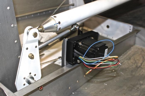

Brief Description:  Install Dynon Pitch Servo

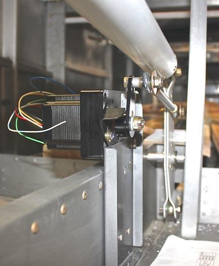

The Pitch servo bracket can use some existing rivet holes so I drilled out 3 floor rivets and two upper rivets. Added 5 additional rivets to complete the mounting. The floor holes were already dimpled so I just countersank the mounting bracket there. Had it off and on several times to position the safety stops where I think they will eventually be. Each shift of the safety bracket moves the stops 18 degrees. Easy enough to re-do after I connect the control tubes for their permanent throw once the elevator is rigged. Will use DB9 connector for the servo wires, except the power wires go to a different place. There will be a Dynon DB9 hub back here to connect the two autopilot servos, the two ADAHRS and one network cable carrying the signals to the Skyview.
Because the elevator control tube is not connected, can't check servo arm interference yet.
1 washer goes inside the white bracket halves. Used a thin strip as a teetertotter to roll washer in..
