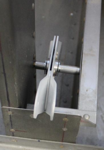

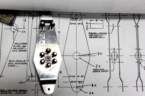

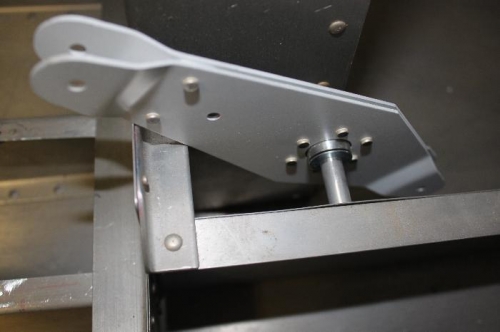

Make the elevator bellcrank
Another small job out of the way. Primed it. Drilled it for the Dynon autopilot servo connecting rod. Made a 15/16 and a 7/16 spacer. Added the large retainer washers and mounted it in the fuselage for one of several times, I'm sure.
