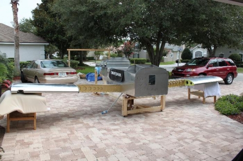

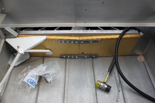

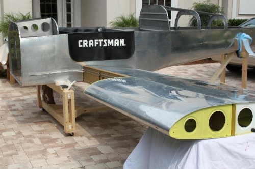

Finally got the airplane outside and inserted/bolted the wings for the 1st time. I used tapered 3/8 hardware store bolts, grinding the threads off and tapering the ends so they can be tapped into place while automatically aligning the holes. Worked like a charm. Next up, set the gear legs according to plans and drill the weldments. Yeah!!
Wings mounted and supported.
Removed tanks, flaps and ailerons for safety.
