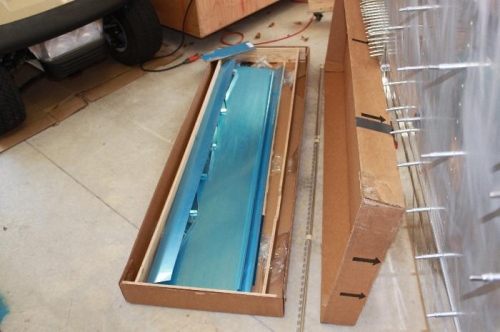

Manual Reference:  New Flaps Arrive

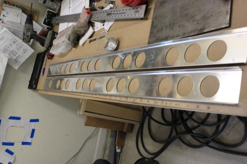

Brief Description:  Make two new flaps

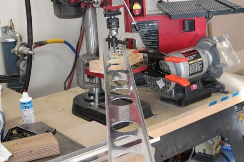

The new flap parts arrived. I began by marking and circle cutting the lightening holes in the flap spars. 26 holes. Then edge smooth all holes, all flange edges, and round the corners. Finally, cut the 1/8 inch slope on the inboard end of each flap spar. That prepares them for the flap attach hardware which I need to make tomorrow.
Vans did an excellent job with packing.  No damage.  Everything was there.
2 1/4 inch diameter holes set on a pattern of 5 1/2
2 1/4 inch diameter holes set on a pattern of 5 1/2", 6",3,3,6,3,3,6,3,3,6,3,3.
Work completed.  On to the flap attach hardware.
