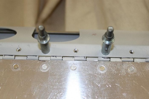

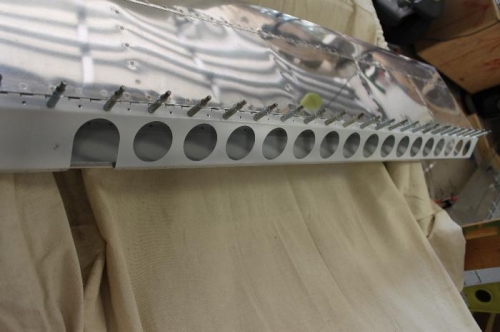

Removed flap brace from wing skin and clecoed every other hole to flap hinge. In a resting position, the flap brace lays across the open end of the flap and can easily be countersunk. Having snapped off an earlier #40 countersink pilot bit, I every so often lubricated the countersink tip with Boelube this time. Using the flap hinge as an additional stiffener and guide, I countersank all open holes, then moved clecoes to already done holes so I could finish countersinking the others. Put the flap all back together and it now swings open almost 90 degrees for easy access.

Countersinking flap brace
Moved clecoes and did remainining holes
