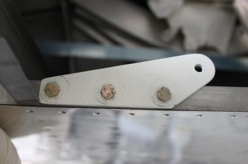

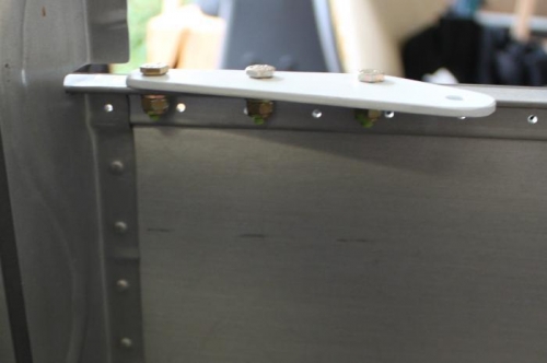

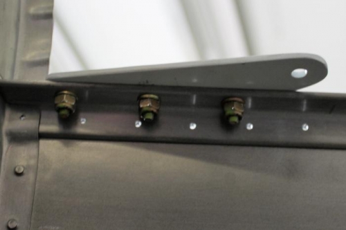

Install the Shoulder Harness Anchors
Painted and installed the seat belt anchor brackets in place and torqued them to 30 inch pounds. I'll have to see if they interfere with riveting a couple of the skin rivets later on.
