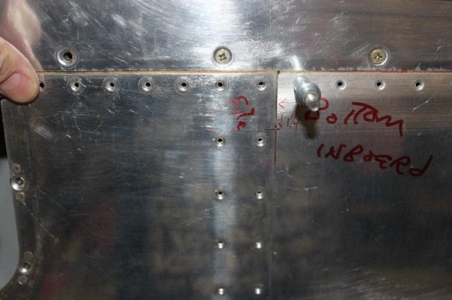

Bottom skin overlap notch cutouts.
Finished the notches in the wing skins. They lay very nicely. I am now ready to rivet the two top skins first, then the inboard bottom skin. Finally!!

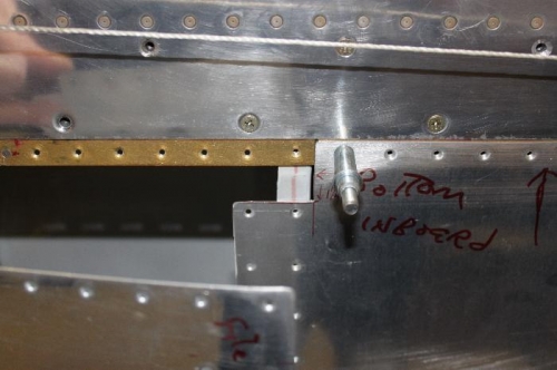

How bottom skin overlap looks after notching for smooth flap hinge

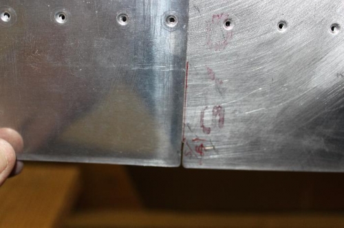

Bottom skin notch out at main spar flange. 1.25" down.
It lays very nicely after notching vs filing.
