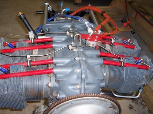

Pickled the Engine
Prepared the engine for a year storage.
It was a suggestion I found online to use a kitchen cutting board to trace the gaskets and then cut them out with my bandsaw,
Dehydrator plugs for moisture

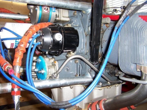

Trimmed up a blue WalMart cutting board for sealups
Same blue seal for governor opening
