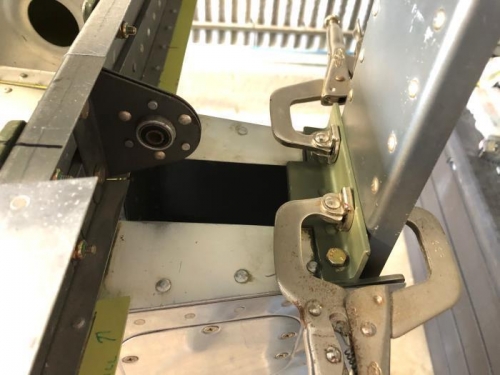

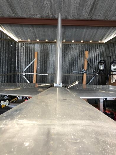

The vertical stabilizer forward spar seems a little too long to position the stabilizer to my satisfaction. I'll investigate the options. I've seen it trimmed on other sites and spacers added to properly fit it in place. I am curious if there is a specific height measurement to match. Clamped it in place while I explore. Also, noted there were occasions where the F681 splice plate (joins Vertical Stabilizer front spar to Horizontal Stabilizer front spar) developed a horizontal crack where it bends so I am also installing a lightweight steel doubler made by Anti Splat Aero LLC.
Vertical clamped in position.
Identical length from top to outer edge of horizontal., On midline.
