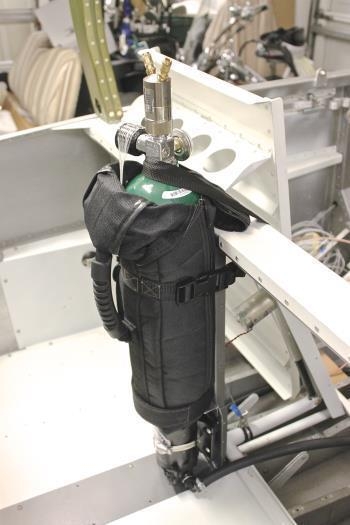

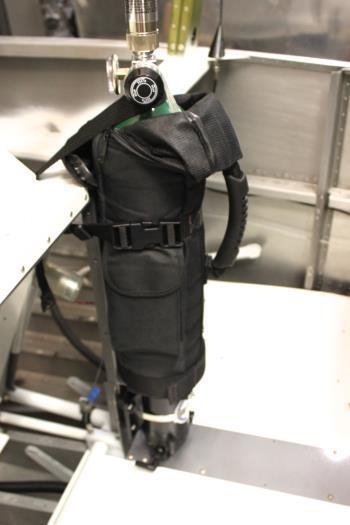

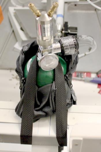

I wanted the O2 tank accessible by me or co pilot so a mid-line mount location seemed right. I added a small 1" angle shelf above the smoke oil pump upon which the tank system could sit. It would be secured with webbing, buckles, and heavy duty Velcro. The existing harness from Aerox doesn't adapt well to RV airplane seats so I removed it from the enclosure cover and made my own. Required a longer piece of 1" web (thanks West Marine) and some attach hardware. The sewing machine was brought down and this practice will make me a better seamster for my seats, I'm sure. Sewed the black buckles onto the Aerox cover, routed the top hold down under, then over the seat back crossmember, around the back of the O2 bottle neck, repeated on other side and secured it. Its secured really nice and the remaining issue was to secure the bottom of the tank so it would sit nearly immobile.
Tank is final mounted in position and secured.
Cover has black buckles I sewed into correct position at the upper attach point.
Upper attach loops around the O2 tank neck and then down under the fuselage cross member on each side.
