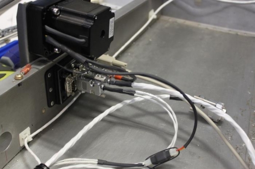

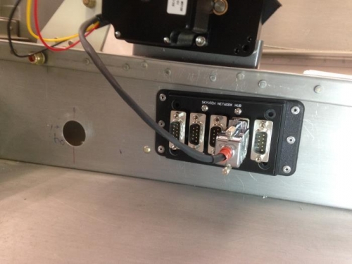

Brief Description:  Wire Dynon Network Bus
Mounted the Dynon network bus beneath the autopilot pitch servo with 6 LP4-3s. The 3 forward-most rivets share the servo doubler metal for extra strength. After running many wires aft of the main wing spar, I started stripping, crimping and shrinking wrapping all over the place. The long network cable was installoed forward into roughly final position so I can cut it and wire it up. Until then, I am using the temporary cable Dynon sent with the package to enable me to connect each ADAHRS, and both autopilot servos to the network. I will secure the wires in a mass-tied bundle. I also left a pull chord through the conduit in case I need to add more wire.
Split out the two pair of serial wires from pitch servo into Network Bus.

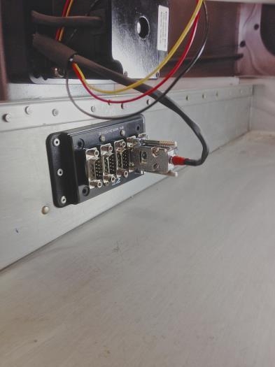

LP4-3 rivets secure it to the aircraft.
Pitch servo power and disconnect wires installed in Molex connector and tied with waxed lacing chord.
