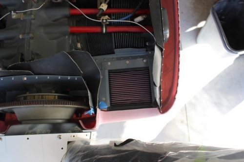

I worried, reading all the stuff about leakage. I took some time to finger-test long flying RV inlet ramps to feel how they sealed. I was pleasantly surprised that most, if not all, were very easy to feel how air could get around the forward most areas of the inlet ramps on each side. I have been worrying needlessly about such minutia. Do the best you can to have overlaps cover the areas and move on. One of the aircraft I checked was missing a rubber seal around the governor oil line up front. And that RV has been flying a long time. See? Do the best you can and move on.
There's no curve at the forward right corner.  Seal material is made to curve a little.

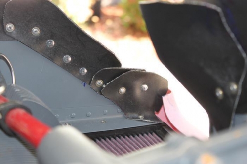

Short pieces allow a nice transition along the inlet ramp as it curves upwards.
This side was easier with the curved inlet ramp piece.  Bottom cowl seal will overlap the open area.
