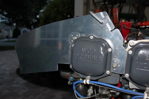

Manual Reference:  Baffles
Brief Description:  Install Engine Baffles 5

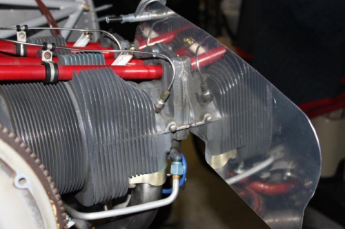

Getting ready to go north for a short vacation. Finished fitting cylinder 2 side. I also made all the underneath combinations and front halves. There is more work to be done as I trim those to fit. They get bent to match up with cowl lines for the inlet ramps. Then I also need to thread the stainless rods that join the front and rear underneath halves. That looks like fun. I've read that perhaps safety wire can work. Also remaining is to get spark plug passthroughs and cutout the openings for those. Also have to decide if I am coming up from the rear with the fuel line off the servo to the spider, like the former B1E engine used. If so, I'll need to drill out a pass through for that.
Cylinder 2 fitted.
Cylinder 2 fitted.
Inside look at Cyliner 2.
