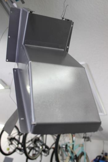

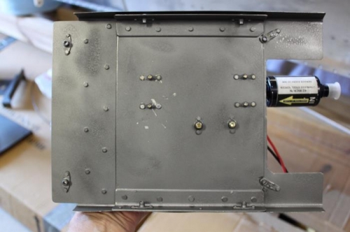

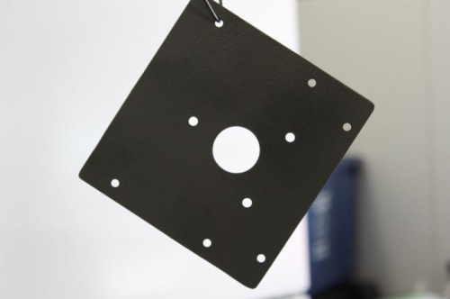

Made use of scraps from cutting out the instrument panel for the dual skyviews. The top plate holds the Andair fuel selector. The 2nd picture shows the underside of the cut off tunnel cover, reinforced with another piece plus side angles and a forward extension that slips underneath the front tunnel cover so they can be screwed together snugly. The pump cover in picture 3 was lowered from normal height so it matches to the size of the Andair pump and Red Cube. It attaches to 4 nutplates shown in picture 2. I also installed 2 nutplates to hold the 1/4 inch bolts used to secure the Red Cube, and 4 -06 nutplates for the Andair pump. I enlarged the pump mounting holes to handle the 6/32 machine screws I used. I did not use the smaller bolts/nuts included in the box from Andair. Also need to determine where to mount the electrical terminal connections for the Red Cube and pump.
Made this top plate from scrap instrument panel stuff.
Top nut plates/angle fit inside floor stiffener. Cover straddles outside of stiffener. Space it right
Riveted these pieces together so it comes off/on as one piece.
