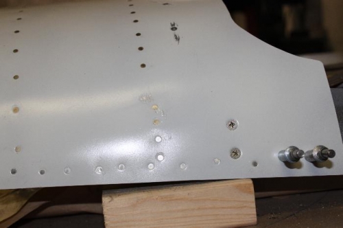

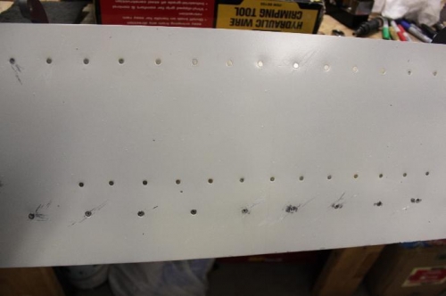

Date:  10-11-2012
Number of Hours:  1.00
Manual Reference:  Canopy Frame
Brief Description:  Canopy Frame 19 - Skin riveted on
Everything that is white epoxy primer will be painted black(inside the canopy profile) or ultimate airplane color (outside the canopy profile and fiberglass fairing). I filed a few of the CS-4 heads that had minor protrusion after setting. I was happy with the overall flush fit of all the riveting. Of course, most all of it will be painted and/or covered with material for the top of the glare shield..
