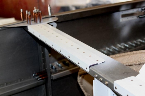

Brief Description:  Riveted Seat Back Braces to F605
Hand squeezer worked on all of these. I sure wish I had a pneumatic one. Before I went too far with the top 426's, I realized primer in the countersinks was causing the heads to sit slightly proud. So for the majority I used the countersink deburring handtool to remove the paint and the rest were perfect. I chucked the rivet head shaver in the drill cage and shaved 4 heads to make them perfectly flush. Nice tool and I needed the practice.
