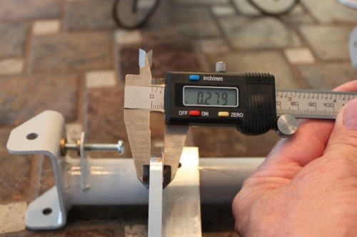

Bearing is .279 wide in mounting bracket.
Glued 2 960-10s and 1 960-10L to leave .2815 space for bracket bearing.

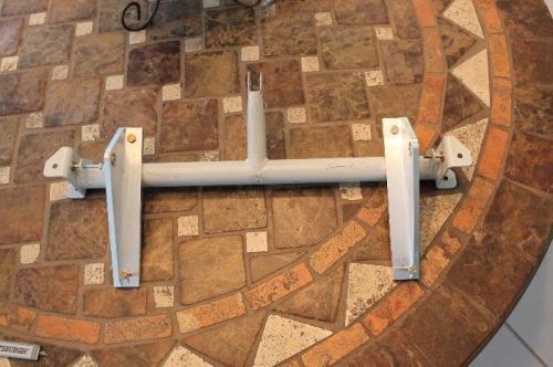

Finished and ready to remount.
