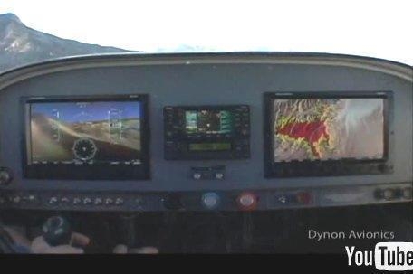

Dynon's RV-6 panel will look similar to mine except I will have the larger GTN750 on top of the SL40 and beneath the PMA5000 audio panel. It will look very similar to the picture below.
Borrowed Dynon's RV-6A Panel Picture
