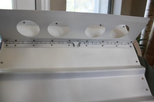

It was fun to rivet this all together. Plans called for AN470AD4-5 for most side rail connection but 4-6 was a better fit so I used those instead. You often find in the plans where the called out rivet is just a little too short for a nice shop head. Split all the hinge pins in half and bent the end 90 degrees as a handle. Remember to heat the bendable portion cherry red with propane torch and bend while red, not while its dark or you risk snapping the bend off.
Front view
Front view

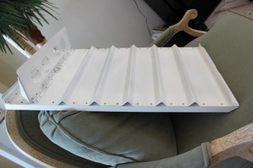

Seat back securing hardware

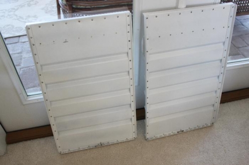

Seat back view
Seat back view
