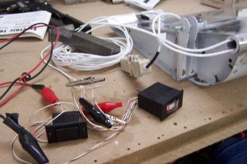

I closed up the aileron and cobbled up all the electrical parts for a full test of all functions. I spliced the panel switch and the trim position indicator and the main wiring run to the trim servo and hooked up my trusty battery for the test. Here is a short You Tube test: Click the play button
The test went fine. The trim tab moved to full stop at both extremes and the indicator followed suit. I can declare this aileron trim servo installation complete.

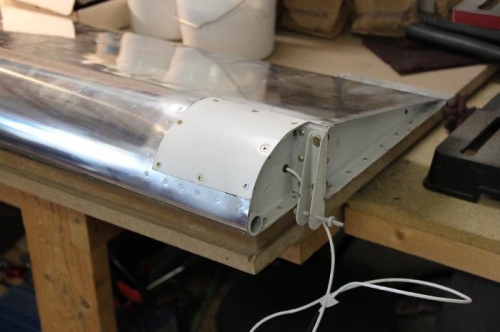

Note the grommet for the wiring to exit the aileron. Cover in place now.

Spliced all parts together for final test.
