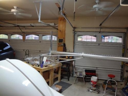

Brief Description:  Fuselage Tail Boom mounting
Section 3(new) step 1.3- do not add washer to bolt on lower bolt hole or boom-tube will not fit and then must disassemble. This took a little extra time I didn't need to waste. Oh well.
Starting to add Linseed Oil to brackets, etc, that may be exposed to water.

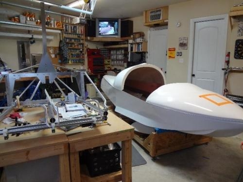

Eventually got boom tube and all bracing in place. I have to admit that it has taken me too much time finding parts and bolts. I am doing this in a garage and I thought my organizing system was good, but not so much now. I would love to have the room to lay things out on the floor or shelves. It took me an hour just to find Fuel Tank Angle Forward 2850-002 and 003
I can see already the garage is getting too crouded for the build.
