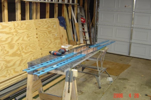

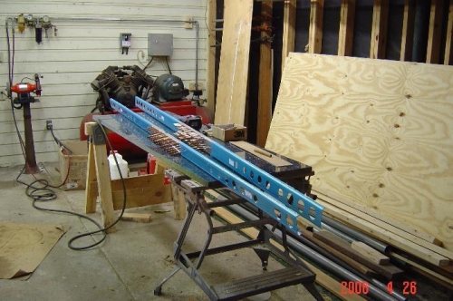

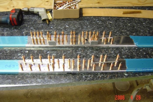

Brief Description:  Front and Rear Stab Spar Cleco and drill
Clecoed and match drilled horizonal stabilizer front and rear spars with doubler plates. Located and drilled the two attach angles to the front spar using the granet plate to hold the flanges on the same plane. Drilled the 5/8 hole for my manual trim cable as shown on print. I have just about made up my mind not to prime anything except non alclad parts. If my C152 has lasted 25 years without primer on the inside I think the RV will do at least as well, probably better since it will never stay outside on the ramp. If the RV lasts 25 years that puts me at 75 years old. At that point I don't really care if it begins to show a little corrosion. Let my Grandson worry about it!Pressure switch on the air compressor blew the diaphram and I had to stop and replace it. Tomorrow is another day.
